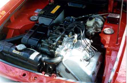

The engine after the restoration
After all these I decide to total restore the engine dissemble it , replacing every item was worn out and assembling it again. That job wasn’t easy for someone amateur like me but I had the help of a friend of mine who is a professional engine mechanic so every time that I had a big problem he was finding the solution for me. I first purchased all the spare parts I need from spare parts stores in Athens and abroad   ( for some rare spare parts that I couldn’t find here) .The whole job it takes about two months for me ( don’t forget that this is my hobby not my employment) but when I finish I was sure that the engine was just like a new one and I was very proud for that. The following procedures are the steps I follow to complete the whole restoration.

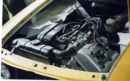

Just after the engine overhauling and before the painting
  1. There was fitted to the engine a shorter oil filter than the normal and as I found later someone had cut the inner pipe of the oil-filter base to fit the more common oil-filter , so I replace the whole base of the oil filter with another one.
