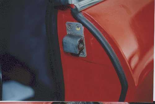

  1. If someone wants to tune the door (if it not closes with the first try) first have to check the seals ,and after that have to control an item that is fitted to the car body exactly against the door lock . He can unscrew the two screws of that and he can move it front or back .In that way he can manage the place of the door when that is closed.
