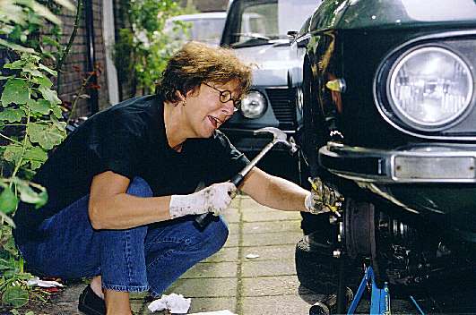

Undoing axle nut
Undoing the axle nut. She has just put aside the two meter extension piece.

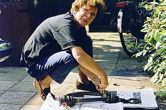

Rebooting outer CVJ
Take the old rubber boot off, clean then new boot, new grease.

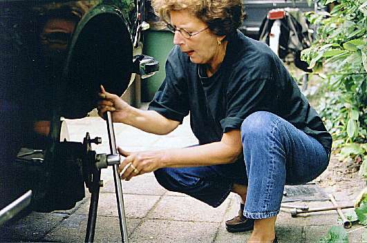

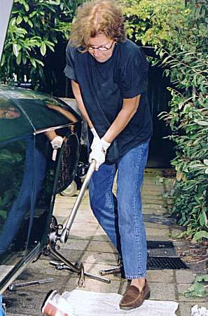

Professionally tightening axle nut to 30 kg/m
"Good tools is half the work" Janneke thinks as she tightens the axle nut to 30 kg/m

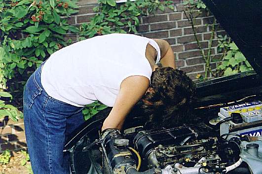

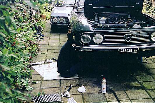

Shock has to be loosened at one end
Shock absorber has to be loosened at one and to allow the upright to drop far enough to take the top bottom ball joint out. She already put a piece of wood between the spring and the subframe to keep the spring up. Used a bottle jack placed under the lower balljoint to do this.

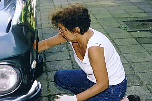

Undoing left front shock absorber
Temperature is rising and after stripping a bit, she goes on to undo the bottom bolt of the left front shock absorber.
