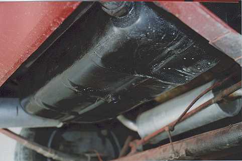

The story begins when I bought my Fulvia at the summer of 1995 . At the first time that I attempted to fill the fuel tank to the top I understood that I had a fuel leakage from the top of the fuel tank under the carpet of the boot. The result of that leakage was a black fluid that dropped from the bottom of the tank to the ground because the fuel dissolve the pitch that covers the tank to protect from rusting When I phone to the previous owner of the car he told me " Oh I forgot to tell you not to fill the tank to the top ,but this is not big problem for you ,just a few more visits to the gas station."
From all the other problems that I had with the car this was the more important because of the fire dangerous so I decided first to replace the old fuel tank with a new one , and second to find the reason of this fuel leakage to eliminate the probability of having the same problem in the future.

I found the cause of the old tank destruction when I understand that I had an water leakage of the boot through many holes of the body .The water that throws through these holes trapped around the upper part of the fuel tank and because of the difficulty to see that water ( you have to remove the spare wheel and lift the rubber carpet ) the water stays there for a long time and destroy the upper part of the fuel tank with rust .
