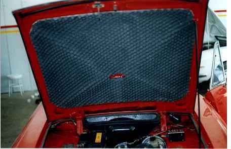

The bonnet .

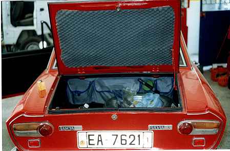

The boot.

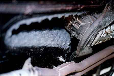

The gearbox area under the car

  4. I glued on the inner surface of both the bonnet and the boot a thick leaf of the cellular material of the second type. This is the most important part of the whole job because the distance between the inner surface of the bonnet and the primitive cause of the noise is very small so that sound hindrance could bee very effective . The only thing that have to mention is the lamp in the middle of the bonnet that has not to be covered from the soundproofing material and the using of a special glue because of the high temperature not only from the engine but from the sunshine too. That material makes the sound of the bonnet and boot shutting very dull and reminds me more younger cars. The reason that cover not only the bonnet but the boot too with that material is first the noise that comes from the back part of the exhaust , and second the covering of the inner surface of it that didn’t like it too much. That material is thick enough that when the bonnet is closed ,touches in some places the engine but I didn’t care about a probability of fire because that material is not only soundproofing but fireproofing too.
  5. I glued the same type of material with the cellular surface on the inner part of the gearbox tunnel to eliminate the noise from that. That job was too difficult not only because the car was standing on an elevator but because there is not a lot of space between the gearbox and the car body so it took time to do that but the result was too effective.
